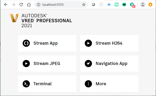

VRED Stream web interface

  1. Open a VRED scene.
  2. Select Edit > Preferences > WebInterface and ensure Enable Web Server is activated.
    Note the port number. The default is 8888.
  3. Click OK.
  4. Open a web browser on your device.
  5. Enter either localhost:8888 or YourIP:8888.
  6. Select Stream JPEG or Stream H264.
