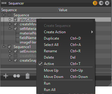

  2. Right-click inside the Sequencer module and select Create Sequence.
  3. Right-click the new sequence, select Create Action, then the action you want from the context menu.
  4. Repeat step 3 to add other actions to the sequence.

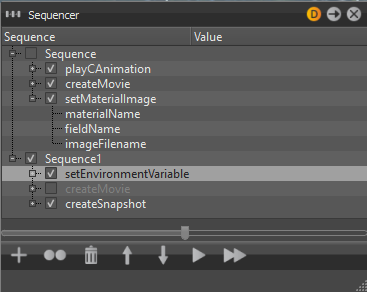

How to Disable an Action Inside a Sequence
To disable an action inside a sequence, deselect the check box beside the action.
Sequencer
How to Use the Icon Bar Controls
  1. Select Interaction > Sequencer.
  2. Use the controls in the Icon Bar to delete, duplicate, or change the order of sequences.
How to Run Command Sequences
To run one sequence, including all its enabled actions:
  1. In the Sequencer module, right-click the sequence you want to run.
  2. Select Run.
    Sequence Run All
To run multiple sequences:
  1. In the Sequencer module, select the check boxes beside the sequences you want to run.
  2. Right-click inside the module and select Run All.
