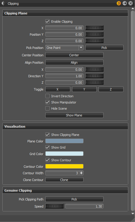

About the Clipping Module
The Clipping module contains three sections, Clipping Plane for making changes to the positioning of the clipping plane, Visualization for changing the look of the clipping plane, and Genuine Clipping for setting a clipping plane path.
Clipping
How to Enable the Clipping Plane
  1. Select Interaction > Clipping to open the Clipping module.
  2. Select Enable Clipping.

How to Change Clipping Plane Appearance
From the Clipping module, use the controls under Visualization to change how the clipping plane looks.
  • Show Clipping Plane - Enable to show the plane or disable to hide it.
  • Plane Color - Set the color of the clipping plane. You can keep the grid visible, while hiding the plane.
  • Show Grid - Enable to show the grid or disable to hide it.
  • Grid Color - Set the color of the grid. You can keep the clipping plane visible, while hiding the grid.
  • Show Contour - Enable to show the line around the part of the object clipped by the plane or disable to hide it.
  • Contour Width - Set the thickness of the contour line.
  • Clone Contour - Click Clone, then Shift-click the contour line to clone it. Once the clipping plane is translated, the clone will be visible.
How to Hide Everything in the Scene Except the Clipping Plane
Select Hide Scene.
How to Align the Camera Parallel to the Clipping Plane
In the Clipping module, under Visualization, enable Show Clipping Plane. This is the inverse of Align, which positions the plane relative to the camera.
How to Create Geometry from the Clipping Contour
In the Clipping module, under Visualization, click Clone. This creates a geometry node from the clipping contour. This node, named Clipping Contour, appears in the Scenegraph.
