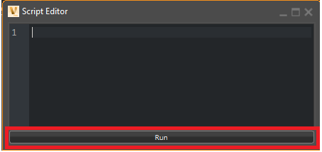

Use the Script Editor, found under Edit > Script Editor, for creating and editing scripts.
How to Run a Script
Use either the main VRED window or Script Editor to run a script.

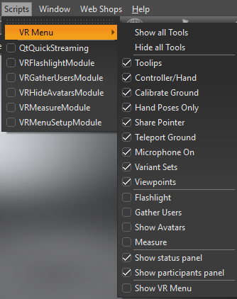

Using the Scripts Menu
The Scripts menu contains options a list of scripted plugins, along with the xR Home Menu options.
Use the options in the xR Home Menu to customize the tools that appear in the xR Home Menu panel used in VR.
When items in this list are checked, they appear in the xR Home Menu. To remove tools from the menu, uncheck them.
VRED comes with an assortment of scripted plugins, which are listed in the Scripts menu.
