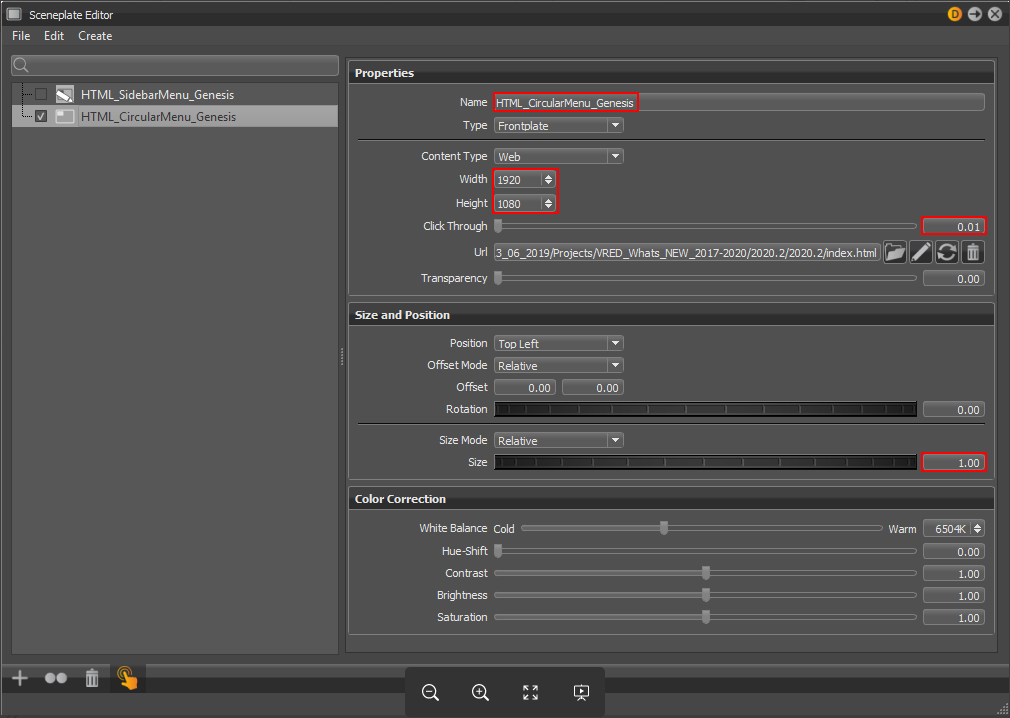

However, to understand how it was created, follow these steps to load the circular menu UI on a frontplate using the Sceneplate Editor:
  1. In the Menu Bar, select Scene > Sceneplate Editor to open the editor.
  2. In the Sceneplate Editor, select Create > Create Frontplate to create a frontplate.
    Sceneplate Editor circular menu settings
  3. In the Properties section to the right, set Content Type to Web.
  4. Adjust the Width and Height to the render window size. This ensures the UI will fit into the render window.
    Note:
    Each time the render window is resized, repeat step 4.
  5. Set Click Through to 0.01 to ensure the circular menu uses transparency backgrounds; otherwise, the UI will not be responsive to user interactions.
  6. Set the URL to the HTML file containing the circular menu. An example file can be found at:
    C:\ProgramData\Autodesk\VREDPro-12.2\Examples\webengine-circular-menu-genesis\index
    Note:
    It is important that all assets, like the icons, the stylesheet, and appropriated JavaScript file, are in the same folder or found at the same URL.
  7. In the Size and Position section, set the Size Mode to Relative and Size to 1.00 for the correct scaling.

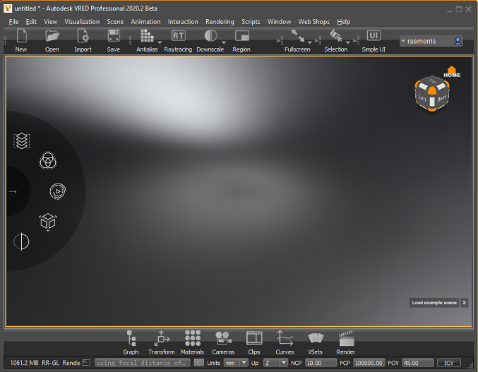

    Circular menu
Configuring the Menu
With the circular menu created, now it's time to configure it. Its configurations are stored in a JSON object inside a script tag in the HTML file. The configuration starts with a root property called menu. Use any of the content from the Menu Properties and Item Properties tables.
