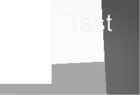

Sceneplates with Transparent Images
Sceneplates with transparent elements use an additional alpha channel for storing the transparency data. There are two ways this alpha channel can be interpreted:
  • Straight Alpha - Only the alpha channel contains transparency information, while the RGFB color channels do NOT. This is widely used and simple. An issue arises, however, when using it in textures. A visible halo may be introduced around semi-transparent pixels, if no special precautions are taken.
    Issue using Straight Alpha in textures
  • Pre-multiplied Alpha - The alpha channel contains transparency information and multiplies it into the other color channels. This makes it good for compositing and for textures; however, it is not widely supported.
Sceneplates support both image types. As most image files do not indicate which alpha representation is use, the Sceneplate Editor has a check box for manually setting the correct type. By default, it is set to Straight Alpha.
  • If you see dark borders around opaque areas, it is likely your image is a premultiplied alpha image, so enable Premultiplied Alpha.
  • If you see bright borders around opaque areas, your image might use a straight alpha image, but Premultiplied Alpha is enabled. Disable Premultiplied Alpha.
