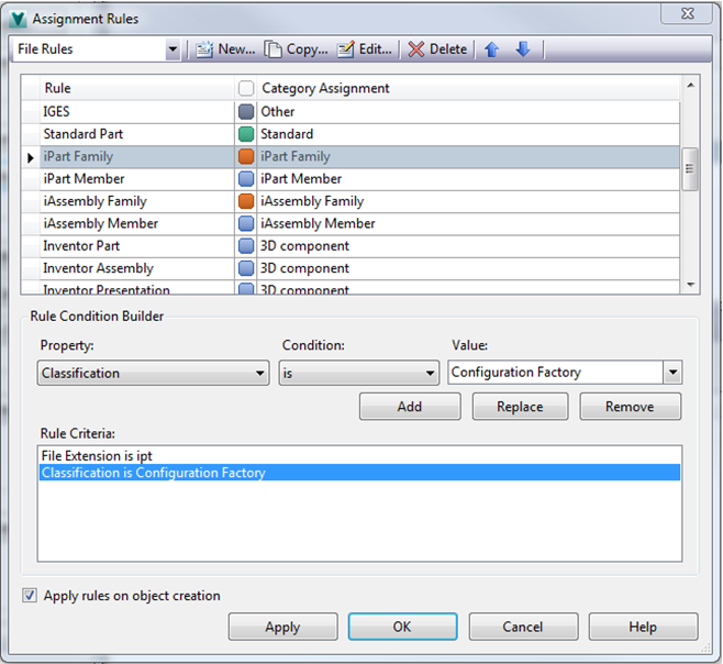

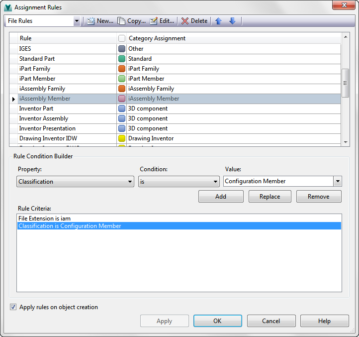

Classify members as a Configuration Member in Vault.
Classify Factories as Configuration Factory in Vault.
