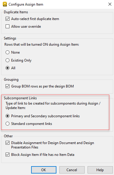

Control the link type for sub-components by configuring whether Primary and Secondary or Standard component links are used during an Assign Item or Update Item event.
