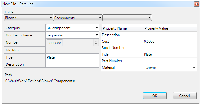

The Vault Data Standard dialog is available in Inventor and AutoCAD. Whenever you first save a file, the Data Standard dialog displays. Fill in the required fields and any additional fields set up by your administrator and click OK to save your data. The data is saved as a Data Sheet that can be modified in the future.
Data Standard for Vault installs default Data Standard dialogs that can be modified by an administrator.
The default dialog differs based on your release of Vault.
Users can enter a new title, description, and company information for the file. All other fields are automatically determined by the XAML.
By default, the following fields are provided.
Users can select a numbering scheme and, if applicable, any prefixes or suffixes. Users can also specify a folder for the file, and enter a title, description, and comments for the file.
The file name is generated when the user clicks OK.

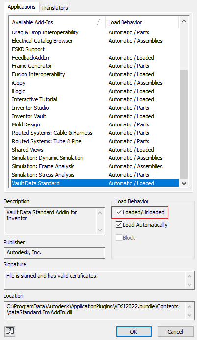

Alternatively, in Autodesk Inventor, on the ribbon, click Tools > Add-Ins.
or
Select the Load Behavior checkbox to load or unload Data Standard.
Once the file is opened, the Data Standard tab becomes visible on the icon ribbon.
Click Disable at any time to stop using it.
When the Data Standard feature is enabled, you are prompted to enter file details every time you first save a file. This occurs whether you click Save on the main toolbar or on the Data Standard ribbon. Enter the required details and click OK to save your data. If the administrator has enabled the Check-in dialog for Vault, you may be prompted to fill your check-in details as well.
Use the Copy command to copy an assembly or part that needs to be modified.
For each new copy, the Data Standard dialog appears when the file is saved for the first time.

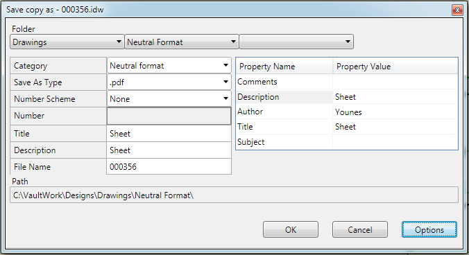

Use Save Copy As to copy parts, assemblies, drawings, or presentations in other formats, such as DWG, STP, PDF, or DXF.
The file is automatically saved in the workspace and the vault. There is no need to perform a Vault check-in.
