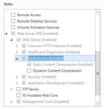

Load Internet Information Services on your Windows Server 2016 or 2019 system.
Load IIS
- From the Windows Desktop Bar, select Server Manager.
- In the Quick Start section of the Dashboard, select Add roles and features.
- For the Installation type, select Role-based or feature-based installation.
- For Server Selection, select the server you are currently working on.
- Select Server Roles on the left and check Web Server (IIS) in the Roles list.
- If prompted to automatically add other services, select Add Features.
- On the Server Roles section, select the following Roles:
- Click Install.
