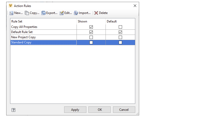

Action Rules Enforcement
Many companies have very strict controls over properties and standards enforcement, and there is a need to restrict the user's ability to reuse part numbers and other file properties. Administrators are now able to enforce a specific Action Rule Set for all users. In Vault 2021, Copy Design Rule Sets are stored on the server instead of the local disk. These Rule Sets are managed by the administrator to enforce desired Copy Design behavior.
