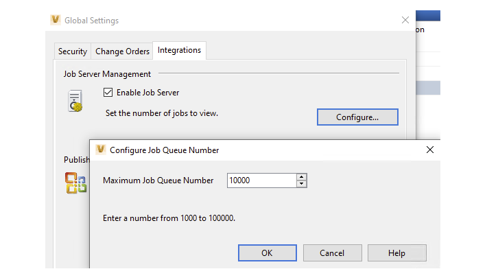

Configure Job Queue Number
You can now set the number of jobs displayed in the Job Queue using a new option in the Integrations tab of the Global Settings dialog box.
When jobs are submitted to the Job Processor's Job Queue, previously only the first 1000 jobs were displayed. In Vault 2021, an administrator can configure the Job Queue' maximum display number from 1000 to 100 000.
