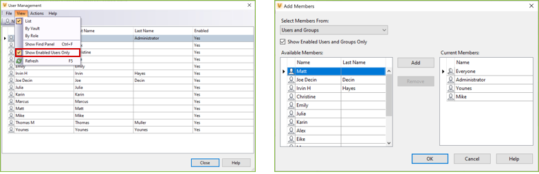

Show/Hide Users
Using the option in the View drop-down enables you to hide or show disabled users.
A Vault Ideas submission

Resizable Details Dialog
To work more easily within the Security tab, the Details Dialog is now resizable.
