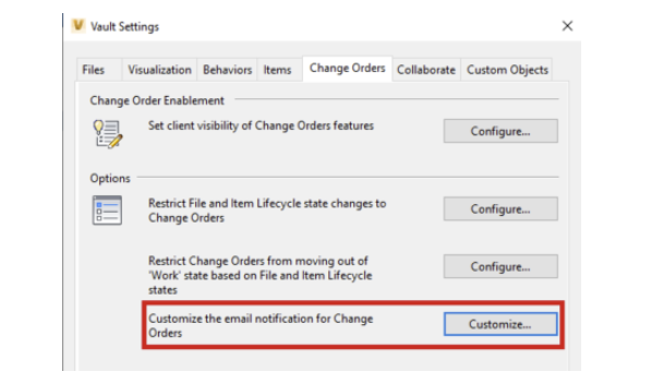

Customize change order email templates, including subject line and body in a central location for all users.
Vault 2021 added the ability to customize the email template for change orders notifications. Access the setting from Vault Settings > Change Orders > Options > Customize. In the dialog box, you can customize the email template. You can customize the email template subject and the body by including Vault Properties.
