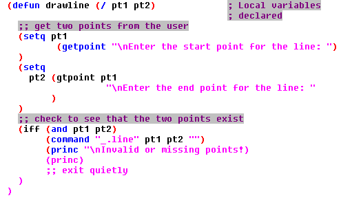

The following coding example shows the advantages of using color coding to identify errors in AutoLISP code.
The previous illustration shows an AutoLISP program with standard color coding applied. With the color coding applied, you can identify the following problems:
