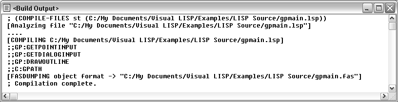

Output messages from this process appear in two Visual LISP windows; the Build Output window and the Console window. The Build Output window contains messages relating to any compilation of AutoLISP source code into .fas files. In a successful compile, the output looks like the following:
The compiler messages identify the following items:
In the above example, four functions are identified: GP:GETPOINTINPUT, GP:GETDIALOGINPUT, GP:DRAWOUTLINE, and C:GPATH.

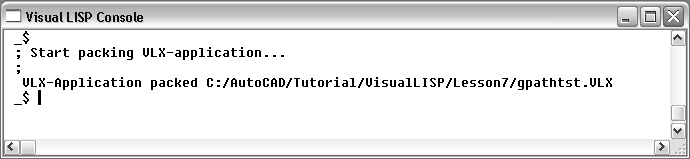

The Visual LISP Console window displays messages relating to the creation of the application executable, the .vlx file. If the Make Application process succeeds, the Console window displays the folder path and file name of the .vlx, as in the following example:
