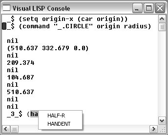

You can complete a partially entered word with a matching symbol name from the Visual LISP symbol table.
(ha
VLISP found two matching words in the symbol table. The half-r symbol is a variable you defined in the Console window, and the handent symbol represents an AutoLISP function.
Note that you can also click Search
Complete Word by Apropos from the VLISP menu instead of pressing Ctrl+Shift+Spacebar to invoke the feature.

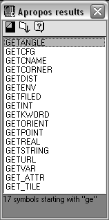

If VLISP finds more than 15 matching names in the symbol table, it displays the Apropos Results dialog box. For example, type get at the Console prompt, then press Ctrl+Shift+Spacebar to invoke the Apropos feature. VLISP displays the following dialog box:
You can select a symbol from the results window and copy it into your code using a shortcut menu. If you need additional help with copying the symbol to your program code, or using other features of the Apropos Results window, see About Using the Results of an Apropos Search.
