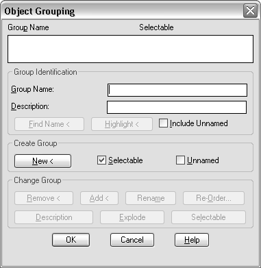

For example, the following figure shows the Object Grouping dialog box. This dialog box contains a Group Name field, where users may enter a name for a new group they are creating. If the Unnamed option is selected, a Group Name cannot be specified.
