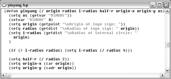

Continue to resume execution of the program. Begin by entering some debugging information in the Visual LISP text editor window containing the yinyang.lsp program.
(setq half-r (/ radius 2))
The following screen snapshot indicates the position of this statement within the program:

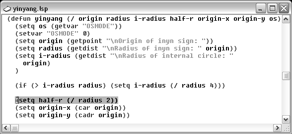

Load Text in Editor to load the yinyang function, if you have not done so already, run it from the Visual LISP Console window prompt by entering the following: (yinyang)
After you reply to the prompts the program displays at the AutoCAD Command prompt, Visual LISP pauses execution at the breakpoint you set and displays the code in the text editor window:
Note how the statement following the cursor is highlighted.
