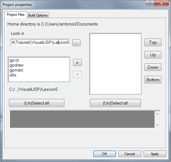

Manages the AutoLISP source files and build options for a project.
In Visual LISP, click Project
Project Properties.
Specifies which files to add to or are in a project.
Lists the project’s folder, and the one to use when looking for and compiling AutoLISP source files.
Specifies the folder that the Project Properties dialog box should look in for AutoLISP source files.
Lists the AutoLISP source files that are found in the folder specified in the Look In box.
Adds the files selected in the AutoLISP Source Files list to the project.
Removes the files selected in the Project Files list from the project.
Lists the AutoLISP source files that have been added to the project. The order of the files controls the order in which the files are loaded when compiling multiple AutoLISP source files into a single FAS file.
Moves the selected file to the top of the Project Files list.
Moves the selected file up one place in the Project Files list.
Moves the selected file down one place in the Project Files list.
Moves the selected file to the bottom of the Project Files list.
Selects or deselects all the selected files in the AutoLISP Source Files and Project Files lists.
Displays status messages about the added files and settings being applied to the project.
