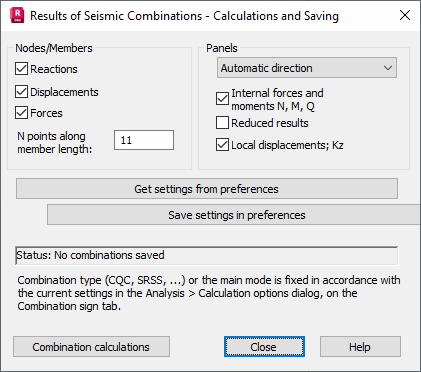

There are two options for saving quadratic combination results:
Select result types to be calculated for seismic analysis combinations in Nodes / Bars and Panels.
Click the Combination calculations button to start the calculation process and save the selected seismic combination results. If results for certain groups have been previously saved, they will not be saved again and calculated results may not be deleted. If you turn off saving the previously calculated result while the save status is active, close and reopen the dialog, this result type will be selected again.
The exception being, if you change result parameters, then it is required to recalculate selected results.
After calculation, either of the following status notifications display:
In the Job Preferences dialog, if you select the Save results only for quadratic combinations and calculations have been run, then results are saved only for combinations without saving them for single modal modes. Results for combinations cannot be calculated because there are no results for individual modes being components of combinations.
