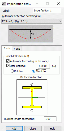

This dialog lets you define a new type of imperfection. Open the Imperfection definition dialog by clicking
on the Geometrical Imperfections dialog.
At the top of the dialog, the Label field lets you enter a name for a geometrical imperfection. Also in this dialog, you define a method for automatically calculating imperfections. You need to select a code and a calculation method.
The dialog has 2 tabs: Y axis and Z axis. The tabs have the same options used for defining the initial deflection in a local system for a bar section (initial deflection can be defined along the local z or y axis).
In the Initial deflection (e0) field, you can determine a value of initial deflection:
At the bottom of the dialog, you can indicate the orientation of the initial deflection. In other words, it determines whether the deflection should be defined on the positive or negative side of the section local axis.
The Buckling length coefficient lets you specify a buckling length coefficient, which is needed to determine the reduced slenderness of a bar.
On the Z axistab by default, Automatic is selected; however, on the Y axis tab, the Automatic and User-defined options are cleared.
