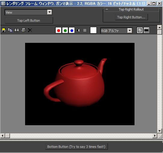

次の例は、..*StdPlugs\StdScripts\VFB_Methods.ms* ファイルに定義されている元のコールバックを削除し、ロールアウト パネルに新しいロールアウトを定義します。

    global MyFirstVFBLayout --the function needs to be global
    fn MyFirstVFBLayout VFB_Interface = ( --will be called by the callback
    --if the window is a Rendered Frame Window,
    if VFB_Interface.IsFramebuffer do (
    --set all borders to 0 to save screen estate
    VFB_Interface.SetMetric #horzMarginLeft 0
    VFB_Interface.SetMetric #horzMarginCenter 0
    VFB_Interface.SetMetric #horzMarginRight 0
    VFB_Interface.SetMetric #vertMarginTop 0
    VFB_Interface.SetMetric #vertMarginCenter 0
    VFB_Interface.SetMetric #vertMarginBottom 0
    VFB_Interface.SetMetric #minClientWidth 320
    VFB_Interface.SetMetric #minClientHeight 240
    --Definesome stand-in rollouts to display in the three panels:
    rollout theTopLeftRollout "Top Left Rollout" width:200 height:45 (
    dropdownlist ddl_topLeft items:#("View","Region","Crop") width:160
    button btn_topLeft "Top Left Button" width:160 )
    rollout theTopRightRollout "Top Right Rollout" width:200 height:50(
    button btn_topLeft"Top Right Button...")
    rollout theBottomRollout "Bottom Rollout" width:200 height:22(
    button btn_bottomButton "Bottom Button (Try to say 3 times fast!)"
    --Initialize the top left panel to a size and
    --get its RolloutFloater value back:
    theTopLeftFloater = VFB_Interface.InitRolloutWindow #TopLeft 200 60
    --Add the rollout to the RolloutFloater without borders and tile bar:
    addRollout theTopLeftRollout theTopLeftFloater border:false
    --and enable the visibility of the top left panel:
    VFB_Interface.SetRolloutWindowVisible #TopLeft true
    --Initialize the top right panel to a size and
    theTopRightFloater = VFB_Interface.InitRolloutWindow #TopRight 200 60
    --add the rollout to the RolloutFloater WITH borders and tile bar:
    addRollout theTopRightRollout theTopRightFloater border:true
    VFB_Interface.SetRolloutWindowVisible #TopRight true
    --Initialize the bottom panel to a size and
    theBottomFloater = VFB_Interface.InitRolloutWindow #Bottom 400 35
    --add the rollout to the RolloutFloater without borders and tile bar:
    addRollout theBottomRollout theBottomFloater border:false
    VFB_Interface.SetRolloutWindowVisible #Bottom true
    VFB_Interface.InitLayout() --finally, initialize the new layout
    )--end if
    )--end fn
    --unregister any related callbacks:
    callbacks.removeScripts #preImageViewerDisplay
    --register a pre-image viewer display callback
    callbacks.addScript #preImageViewerDisplay "MyFirstVFBLayout (callbacks.notificationParam())" id:#ResizeVFBPanels
    )--end script
