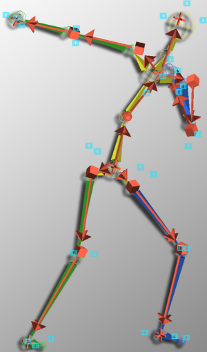

The flexible mocap workflow provides a flexible and open solving solution that is based on Human Inverse Kinematics (HIK) or your custom solver. You can use the Flexible Mocap workflow to easily and precisely apply the optical motion capture data to the HIK defined character skeleton. You can select the markers as a source, modify the input markers, adjust or override the extraction solve, and stretch the characters spine and neck to achieve realism in the solve.
