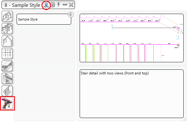

- In the AstorCurrentAddIn database, access the DetBaseCategories table and enter the category image filename of your category PNG files (active and inactive) in the Image and ImageInactive columns for your new drawing style category entry.
- In the AstorCurrentAddIn database, access the DetailMasterTable table and enter the category image filename of your style example PNG file in the ExamplePicture column.
- In the AstorCurrentAddIn database, access the DetailMasterTable table and enter the descriptive text for your style in the HelpText column.
- Save and close the database, restart Advance Steel and open the
Drawing Styles palette to see your new category.
Note: Make sure you select the User category in the top right of the palette heading.
