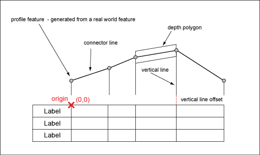

Profile feature classes store the points, lines, and labels for each profile. Profile feature classes represent two types of features:
A real world feature (parent), such as a manhole cover. Each real world feature corresponds to a profile feature. Real world features are profile objects that are normally displayed in the global reference system. The profile feature class stores the relation to the real world feature in the attribute FID_PARENT.
Decoration elements of the profile drawing, such as frame lines, legend, and fix labels. Decoration elements do not correspond to any real world features.
For example, a profile feature of WW_LINE_PRO stores the profile line that corresponds to a real world feature of WW_LINE.
Use the Data Model administrator to create the profile feature classes. Usually you have one corresponding profile feature class for each real world feature class. The following table is an example of how a wastewater profile could be stored.
Profile component Profile feature class (example) Level of detail
Network line WW_LINE_PRO detail
Network point WW_POINT_PRO detail
Feature label WW_LINE_PRO_TBL
WW_POINT_PRO_TBL
sub detail
Vertical line WW_PROFILE_LINE_PRO detail
Connector line WW_PROFILE_LINE_PRO detail
Symbol such as origin, reference height WW_PROFILE_POINT_PRO detail
Polygon WW_PROFILE_POLYGON_PRO detail
Static text such as height, legend labels WW_PROFILE_STATIC_TEXT detail and sub detail
