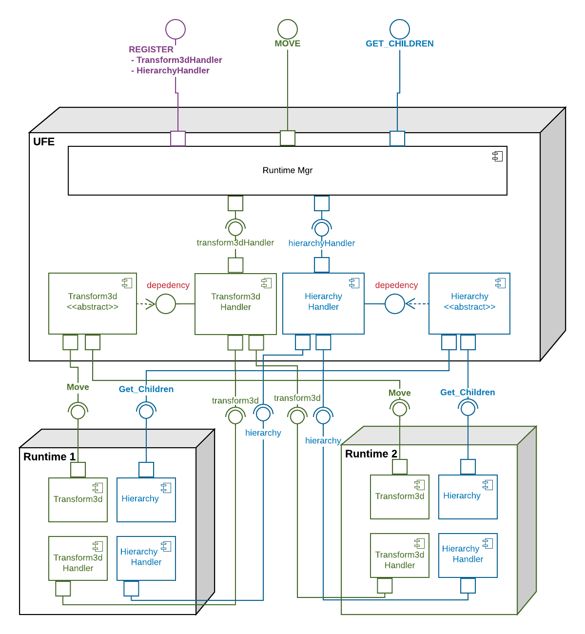

The sequence of steps, and the software components that participate in implementing this scheme, are the following. Let us call the plug-in that provides UFE support to the DCC the UFE plug-in. Since this is the most flexible way of providing UFE support in a DCC, we will base our description on this approach, though DCC builtin code can follow exactly the same procedure.

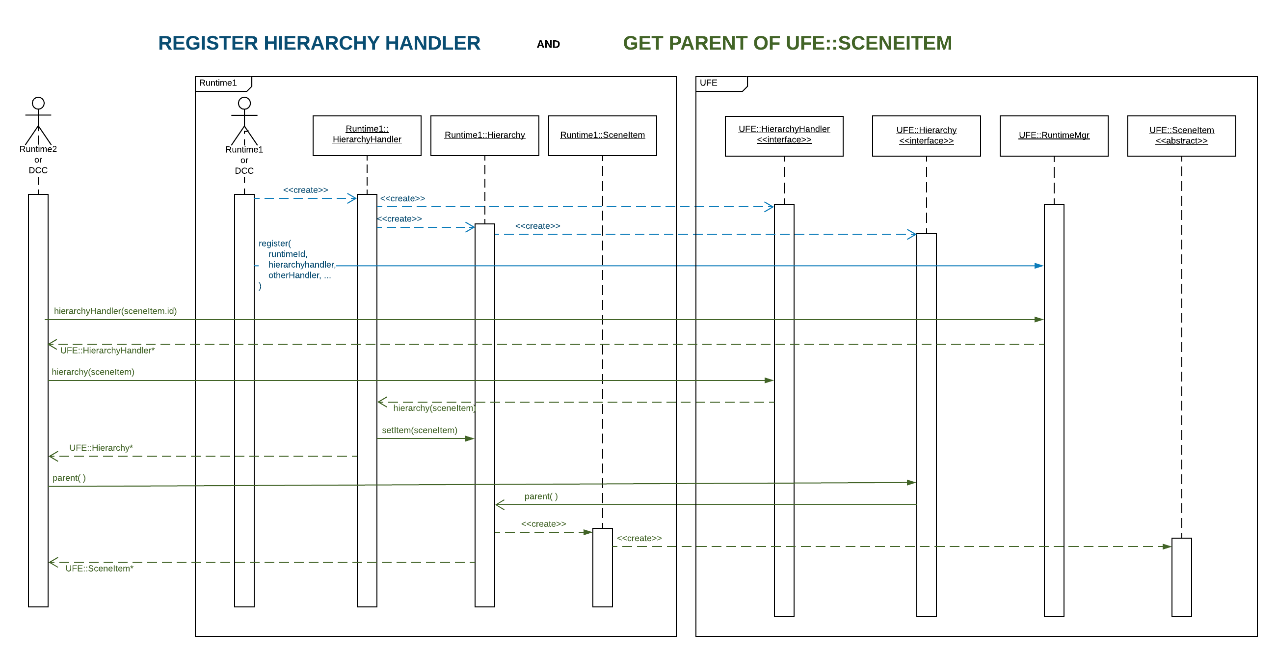

  • At plug-in load time, the UFE plug-in registers its interface implementations with the UFE runtime manager, using Ufe::RunTimeMgr::register_() . The plug-in registers one handler per interface it supports. Each handler is a singleton that will handle all interface object creation for the interface it handles. If no handler is registered by a runtime for a given interface, requesting an interface object for any scene item from that runtime will return a null pointer.
  • To view or edit an object from a UFE-enabled runtime, the DCC creates an interface object on a scene item. If the scene item supports the interface, a pointer to a valid interface object is returned. If the scene item does not support the interface, a null pointer is returned.

  • Internally, UFE uses the handler for the requested interface to create, or bind an existing interface object to the scene item. The runtime that is used is the runtime corresponding to the ID of the final segment in the path. The runtime manager accesses the interface handler for that runtime, and asks the interface handler to return the interface object. This is hidden from the caller, but must be understood by the runtime implementer.
The following component diagram illustrates the responsibilities and dependencies of the different objects.

The following sequence diagram illustrates the flow of control between the different components and objects.
Sequence Diagram
