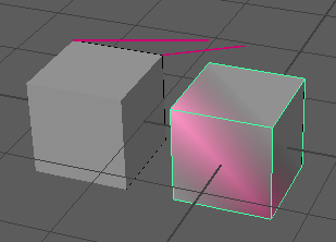

在下面提供的示例演示了如何将元数据的两个流(StreamOne 和 StreamTwo)附加到两个对象(smcPlane 和 smcPlane1)上的顶点,以及如何在 Viewport 2.0 中逐个可视化数据流。它以禁用可视化结束。
// Start a new scene and create two cubes file -new -f; polyCube -n smcPlane -ch off; pickWalk -d down; move -r 1.5 0 0 ; polyCube -n smcPlane1 -ch off; pickWalk -d down; // Define the data structure and create and attach the data streams to the two shapes dataStructure -format "raw" -asString "name=ColorStruct:float[3]=Color"; addMetadata -streamName "StreamOne" -channelName "vertex" -structure "ColorStruct" smcPlaneShape smcPlane1Shape; addMetadata -streamName "StreamTwo" -channelName "vertex" -structure "ColorStruct" smcPlaneShape smcPlane1Shape; // Assign metadata values to the two streams editMetadata -streamName "StreamOne" -value 0.25 -value 1.25 -value 2 -index 1 smcPlaneShape; editMetadata -streamName "StreamTwo" -value -2 -value -0.5 -value 2.5 -index 2 smcPlaneShape; editMetadata -streamName "StreamTwo" -value -4 -value -0.5 -value 2.5 -index 3 smcPlaneShape; editMetadata -streamName "StreamTwo" -value -1.25 -value -0.75 -value 3 -index 4 smcPlane1Shape; editMetadata -streamName "StreamOne" -value 6 -value 2 -value 3.5 -index 5 smcPlane1Shape; editMetadata -streamName "StreamOne" -value 2 -value 0.5 -value 1 -index 6 smcPlane1Shape; // NOTE: By default, all streams are hidden. // Activate visualization of "StreamOne" for one cube. Use color mode. showMetadata -stream "StreamOne" -member "Color" -dataType "float[3]" -method "color" smcPlane1Shape; // Metadata is now visible. // Auto remap the data range of the values in the stream. showMetadata -stream "StreamOne" -member "Color" -dataType "float[3]" -method "color" -auto smcPlane1Shape; // Enable color interpolation to extrapolate color to the faces surrounding the vertices showMetadata -stream "StreamOne" -member "Color" -dataType "float[3]" -method "color" -interpolation true smcPlane1Shape; // Activate visualization of "StreamOne" for the other cube. Use string mode. showMetadata -stream "StreamOne" -member "Color" -dataType "float[3]" -method "string" smcPlaneShape; // Metadata is now visible on both cubes. // Now, activate visualization of "StreamTwo" for the second cube. Use ray mode. showMetadata -stream "StreamTwo" -member "Color" -dataType "float[3]" -method "ray" smcPlaneShape; // The rays appear too long. // Scale the length using the rayscale flag. showMetadata -stream "StreamTwo" -member "Color" -dataType "float[3]" -method "ray" -rayScale 0.3 smcPlaneShape; // The visible metadata has now changed, and you have now used all three methods of display. // Deactivate the stream. To turn off visualization on an object, specify the stream name and use the off flag. showMetadata -stream "StreamTwo" -member "Color" -dataType "float[3]" -off smcPlaneShape; // Now metadata is no longer visible on the second cube (smcPlaneShape)
在此示例中,在 smcPlaneShape 上以光线模式可视化 StreamTwo,其中“光线长度比例”(Ray length scale)设置为 0.3,而在 smcPlane1Shape 上以颜色模式可视化 StreamOne,其中数据范围自动重映射且颜色插值已启用。
