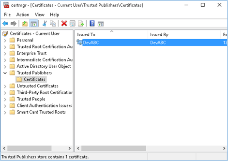

Import the Digital Certificate to Windows Certificate Store
One more step you need when you are making your own digital certificate is to import it to your computer. You can do this in Certificate Manager (CertMgr.msc) or CertUtils.exe tool. Here we use the UI tool. Please refer here for alternatives.
  1. From Start >> Run >> CertMgr.msc. (Or on Windows 8.1/10, right click on Start >> Run >> CertMgr.msc) CertMgr opens.
  2. On CertMgr dialog, right click on Trusted Publishers >> All Tasks >> Import …
  3. Follow the instructions on Certificate Import Wizard. Click Next.
  4. On a dialog which asks "Files to Import", choose the pfx file you want to import.
  5. On the "Password" dialog, enter the password. Keep "Include all extended properties" checked.
  6. Choose "Place all certificates in the following store" then Click Next.
  7. Confirm and Finish.
  8. If you see "Import a new Private signature key" dialog, click OK. (This part may differ depending on your environment.)
  9. Repeat the same step with Trusted Root Certification Authorities. This step is to validate digitally signed binary files.
