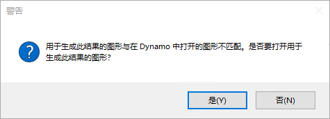

    将显示以下警告:
    The graph used to generate this outcome does not match the graph that is open in Dynamo. Would you like to open the graph used to generate this outcome? Yes/No
  4. 单击“是”。
