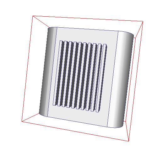

The External Volume tool creates a rectangular volume that completely surrounds the original geometry.

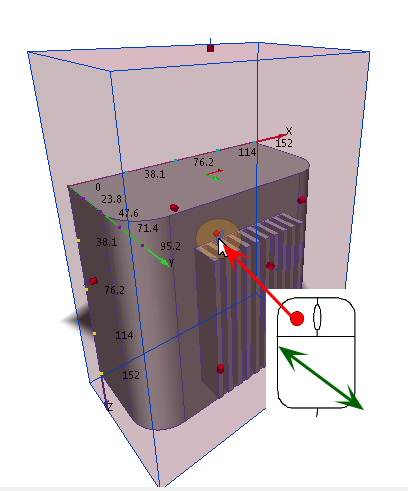

The surfaces and edges of the volume cannot contact or intersect any part of the model. The minimum size is 5% larger than the geometry in all three Cartesian directions.

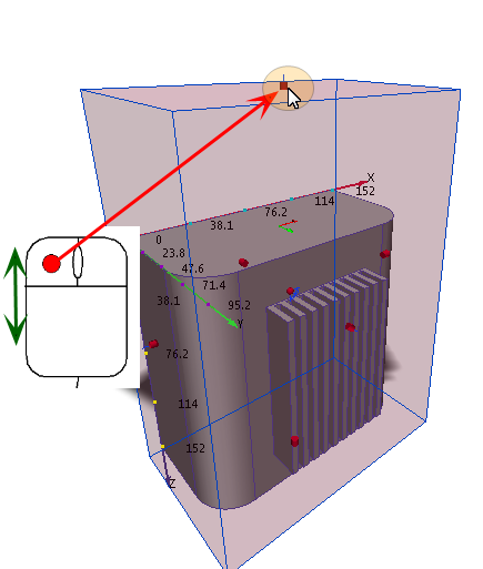

When the External Volume tab is first opened, a red outline of the external volume surrounds the model:

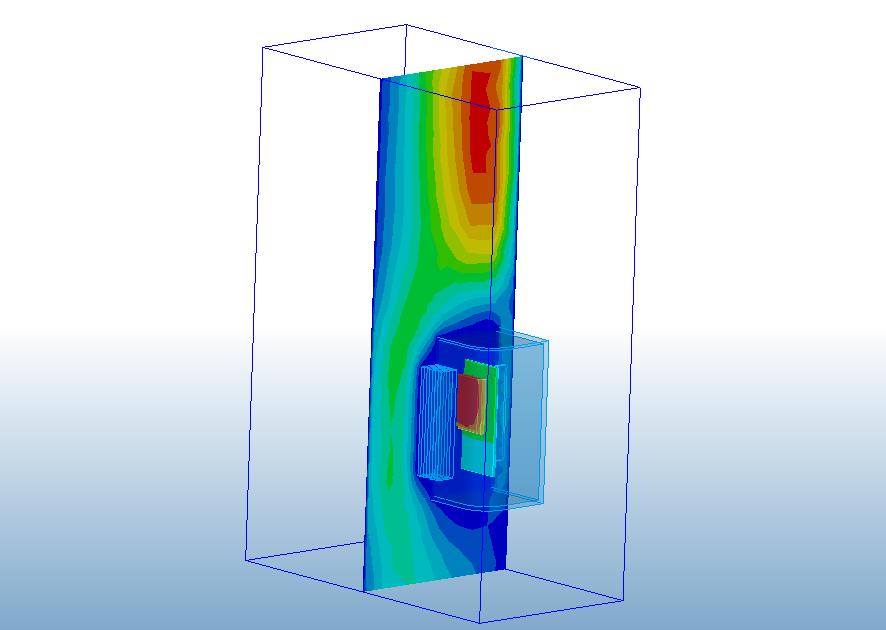

An external volume becomes part of the analysis, and can have boundary conditions, materials, etc., applied to it.
