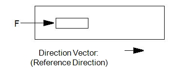

Driving forces are forces that are positive when acting in the direction of motion specified on the Motion task dialog. A negative driving force will act in the opposite direction.
Examples of driving forces include electromagnetic and other body forces as well as forces imposed by objects omitted from the analysis geometry. The force will act in the same direction as the direction of motion (as specified on the Motion task dialog):

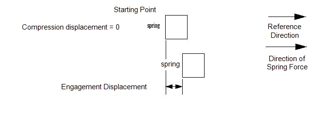

If the object is not touching the spring at time = 0, then the configuration may appear as:

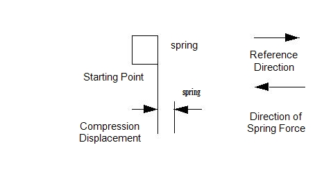

If the object is touching the spring at time=0, then the engagement displacement is 0:

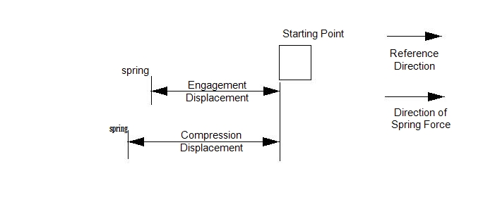

If at time = 0 the spring is fully compressed by the object, then the compression displacement is zero, and the engagement displacement is the distance to where the spring is no longer compressed:

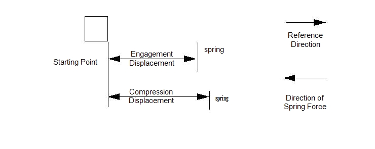

If the object has to travel in a direction opposite of its Reference Direction to contact a spring, then the displacements should be applied as negative values:

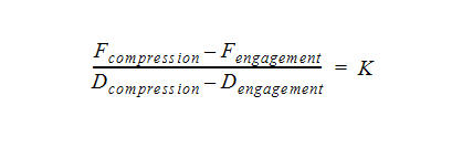

The relationship between the required parameters and the spring constant is given as:
