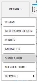

Once a model opened in Fusion 360:
Click the Workspace drop-down menu.
Select Simulation.
In the New Study Window, Select Simplify Model
