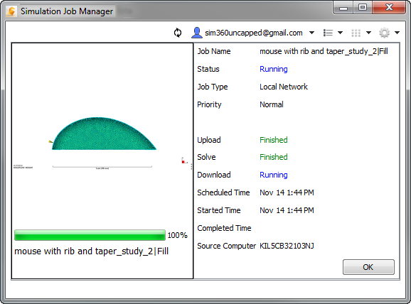

Detail view shows you the status of a specific job, the time is started and finished, whether is was run locally or on the cloud, and which local computer it was run on.
To monitor the progress or to see the details of a specific job, either left-click on a thumbnail image or right-click on the thumbnail image, and select Details.
These are the details displayed for each job:
Job Name: This is the name you assigned to the job. The actual name displayed in the details view depends on the naming convention of the specific Autodesk® 360 product.
Status: You can view the current status of each stage in the simulation process. There are several possible status conditions:
Job Type: Jobs that are run through your Autodesk Account are designated as Cloud. Jobs run on the local workstation are designated as Local Network.
Priority: By default, local jobs are Normal priority. This means that they run in the order in which they are submitted. If, however, it is necessary to run a local job sooner than in the submitted order, increase its priority to High. This causes the job to run next, after the current job is finished, regardless of how many jobs were submitted before it. Likewise, to cause a job to run later than in the submitted order, change its priority to Low.
Cost (applicable only to Cloud jobs): This value indicates the cost of the job, in terms of tokens.
Simulation process stages:
The times indicate when the job achieves a specific status:
To return to the thumbnail view, click OK.
