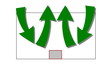

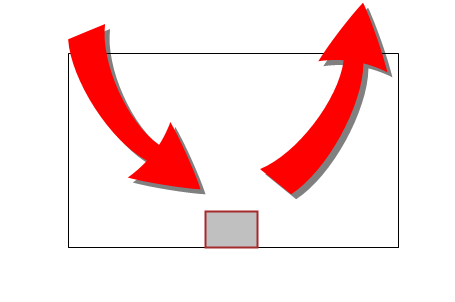

Ideally the flow should enter from the sides of the opening, and exit through the center(forming the plume from the fixture), as shown on the left. Flow should not enter from just one side and exit near the other side, as shown on the right:
If the flow enters from one side and exits through the other, the recommended action is to refine the mesh above the fixture. A convenient method is to create a mesh refinement region directly above the fixture. The flow gradients will be computed more accurately by focusing the mesh in this region.
