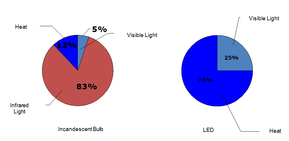

However, some difficult thermal challenges are associated with LED lighting systems. Roughly 75-85% of the total energy applied to an LED is converted into heat that needs to be conducted through a PCB and heat sink before being convected to the surrounding air. Junction temperatures can often range between 90 and 120 °C. The additional challenge is that LEDs need to run at much cooler temperatures than other lamp types.
