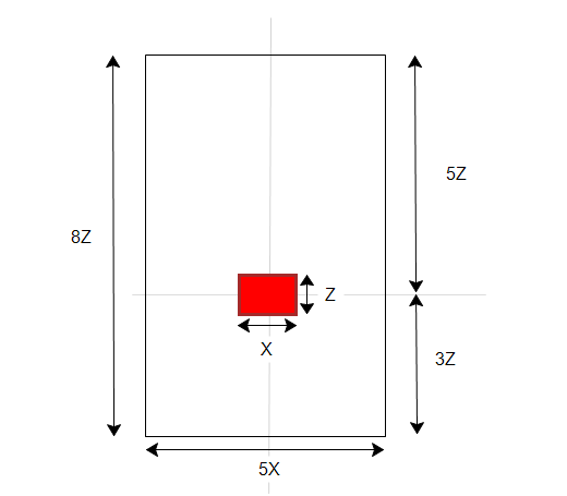

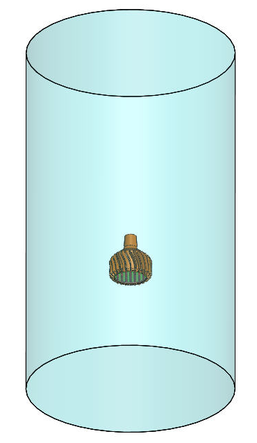

Air Column
Construct a cylindrical enclosure around the bulb, and center it horizontally within the enclosure. The size of the enclosure should be based on the size of the device, as shown below.
To model different orientations of the bulb, modify the orientation of the air cylinder instead of the bulb. This allows Summary entities (Points, Planes, XY plots) created for one orientation to be used for comparing results from other orientations in the Decision Center.

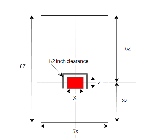

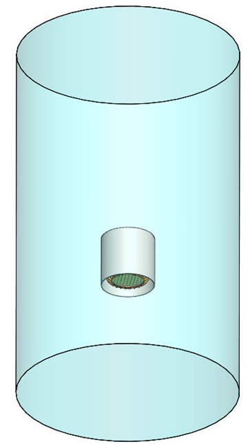

Can Enclosure
A can restricts the airflow around the bulb, and can better predict installed performance.
Construct a cylinder around the bulb with a half inch clearance.
