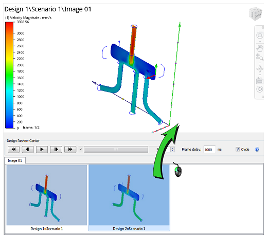

A thumbnail image from each scenario appears in the Design Review Center. If a scenario has not been run or needs to be updated, a place-holder image appears instead.
The first image is shown in the Graphics window. To show the others, left click on each and drag into the graphics window.
To compare the views, use the Design Review Center slider and animation controls.

By default, a single view-port is active, and results are compared by flipping between views with the Design Review Center controls. This means that results from only one scenario are visible at a time. An alternative workflow is to compare results from different scenarios side-by-side. In many situations, this provides a more convenient way to compare results, especially when the differences are subtle.
The viewport with the Autodesk® CFD icon in the lower right corner is the active view, and can be navigated. To activate a different viewport, simply click on it. To navigate multiple views together, click View (tab) > Windows (panel) > Link Views.
