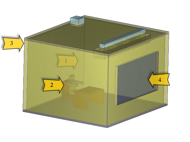

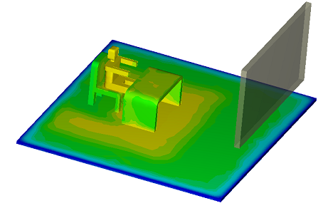

In the following results image, we see the effect of solar radiation passing through a window opposite the occupant. The higher temperature regions on the floor are from solar radiation entering the space. The lower temperature behind the chair is caused by the shadow cast by the desk and occupant:

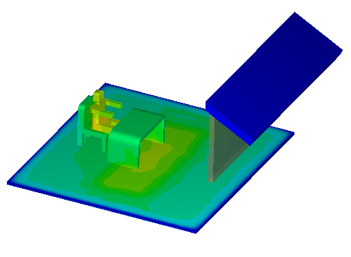

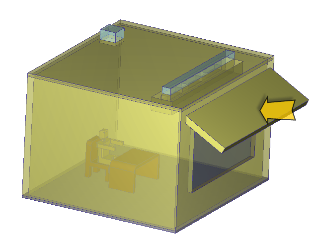

In this image, we've added an awning to the outside of the structure to partially block the sunlight from passing through the window. Note the difference in the temperature footprint on the floor caused by the reduction of solar energy entering the room:

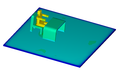

To contrast, we've disabled solar radiation from the simulation in the following image. The window was replaced with an opaque wall, and a constant film coefficient applied to all wall surfaces. Because there is no shadowing effect due to solar radiation passing through the window, the temperature is uniform across the floor:

To include an awning to deflect sunlight, add a volume or part to the outside of the structure. It does not contact any fluid, but does block solar radiation, thus casting a shadow.

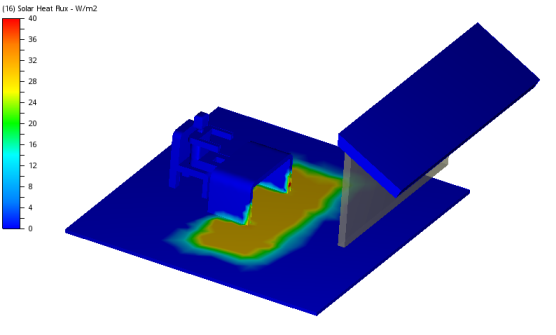

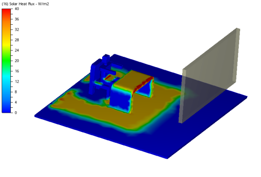

The two result quantities that provide the greatest insight for solar heating simulations are Temperature and Solar Heat Flux. Autodesk® CFD automatically enables Solar Heat Flux for solar heating simulations. It is best to view Solar Heat Flux as a global quantity as it appears on surfaces of the model. In the following examples, we display Solar Heat Flux on the models with and without an awning. In both cases, the simulated time and date is noon in early December, and the location is in the Mid-Atlantic region of the United States:
In both cases the sun is low on the horizon, and casts a long footprint on the floor. In the case with the awning, much of the sunlight is blocked, and the solar footprint appears only in front of the desk. Without the awning, the footprint extends through the room, and there is a shadow behind the occupant.
