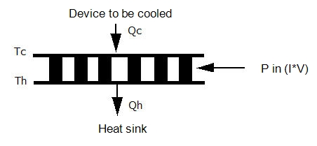

A simple schematic of a TEC device is shown:
In this diagram, the TEC device is used as a cooling device.

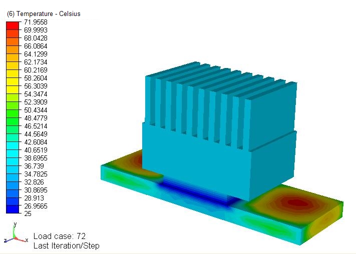

The physical performance of the TEC device within the assembly is best visualized by plotting temperature:

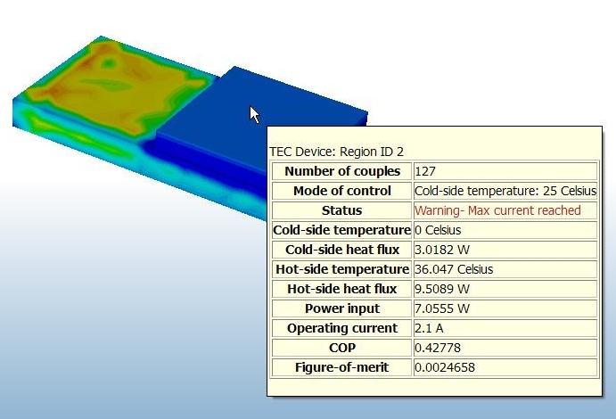

In the case shown above, heat is moved from the chip to the heat sink, and the sensing surface of the TEC device is maintained at 25 C. By hovering the mouse above the TEC device, a pop-up window will appear, showing a collection of data:
This data is also saved in the Component Thermal Summary file, accessible from Review_Component Thermal Summary in the main menu.
The output quantities are:
