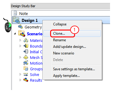

In Autodesk® CFD, on the Design Study bar, right click on a Design, and click Clone.

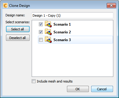

In the Clone Design dialog, assign a unique name to the new Design. Select the scenarios you wish to include in the cloned design, and indicate if you want to clone the mesh and results as well as the geometry and settings (with the Include mesh and results check box).
