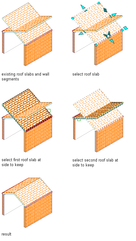

Use this procedure to miter 2 intersecting slabs or roof slabs.
Both slabs or roof slabs are trimmed along the intersection of their perimeter lines. Vertices are added or removed as required. The new edges of the slabs or roof slabs are set to angles required for a true miter cut. If the slab thicknesses of the two edges are different, the angles are different.
If you want to miter slabs or roof slabs that do not intersect, you can miter them by edges.
Mitering roof slabs by intersection
if the object selected is… | then… |
a slab | click ![]() ![]() ![]() |
a roof slab | click ![]() ![]() ![]() |
The opposite side is trimmed.
