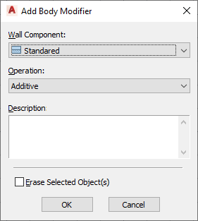

Use this procedure to create a body modifier for a slab or roof slab.
Like interference conditions, body modifiers let you modify the geometry of a slab or roof slab by incorporating another three-dimensional (3D) object. However, where interference conditions always subtract from the mass of a slab or roof slab and affect only components that they touch, body modifiers can be used to add to, subtract from, or completely replace a specific component. If a slab or roof slab has only one component, then the body modifier applies to the entire slab or roof slab.
You can create a body modifier from a mass element, a mass group, or any other AEC object with mass. You can also create body modifiers from ACIS solids or blocks that form 3D bodies. You must place the object in the location you want in the drawing before defining the object as a body modifier.
After you create a body modifier from an object, you can delete the original object. However, if you have created a complex object, such as a mass group comprising many mass elements, you may want to retain the object in the drawing until you are sure you have the results you want for the slab or roof slab.
