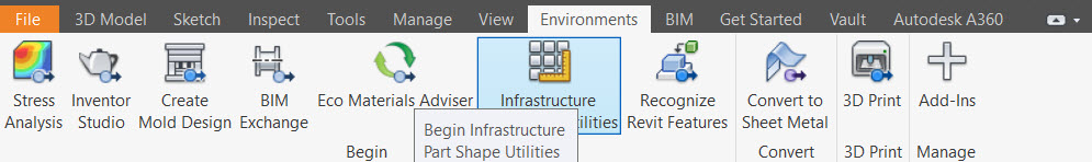

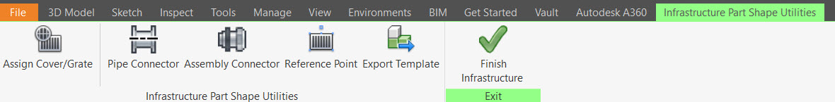

To access the Infrastructure Part Shape Utilities tools
  1. Close Autodesk Civil 3D.
  2. Open Autodesk Inventor.
  3. Click the Environments Tab in the Autodesk Inventor Ribbon.
  4. Click Infrastructure Part Shape Utilities.
  5. The Infrastructure Part Shape Utilities tools are now available to use.
