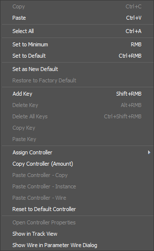

To open the spinner right-click menu, right-click the editable field of an animatable parameter. This menu provides options for cutting, copying, and pasting values, wires, and animation tracks between various object parameters. It also allows you to show the parameter in Track View or in the Parameter Wiring dialog.
With the exceptions of Undo and Select All, each of the following commands takes effect on the parameter you right-click. It's not necessary to first click in the value field. However, to use certain commands such as Copy and Delete, the value to be affected must first be highlighted.
Reverses the effect of the last action.
Removes highlighted text to be pasted elsewhere.
Copies highlighted text to be pasted elsewhere.
Inserts cut or copied text into the editable field.
Removes highlighted text.
Highlights all text within the active editable field.
Assigns a copy of the controller in the buffer to the right-clicked field.
Assigns an instance of the copied controller to the right-clicked field.
Opens a Parameter Wiring dialog with the copied controller parameter and the paste destination parameter selected. This is equivalent to creating a wire parameter in the viewport between two parameters.
Copies the animation controller, including all animation keys, to a buffer, which you can then assign elsewhere by pasting.
Assigns a copy of animation controller in the buffer to the right-clicked field.
Assigns an instance of the copied animation controller to the right-clicked field.
Opens a Parameter Wiring dialog with the copied parameter and the paste destination parameter selected. This is equivalent to creating a wire parameter in the viewport between two parameters.
Opens the Parameter Wiring dialog expanded and positioned to show the wire controller assigned to the selected parameter.
Opens a Track View - Curve Editor window, titled “Selected,” expanded and positioned to show the selected parameter. This is very useful for fast access to a particular curve or track.
Opens a Parameter Wiring Dialog with a focus on the selected parameter.
