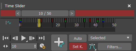

In Set Key mode, the workflow is similar, but the behavior is fundamentally different. Turn on Set Key mode, then move to a point in time. Before you transform or change object parameters, you determine the tracks you want to set keys on using Keyable icons in Track View and Filters. Once you know what you plan to key, you try out poses in the viewport (transform the objects, change parameters, and so forth).
When you like what you see, click the large Set Keys button or press
K on the keyboard to set a key. If you don't do this, no keys are set.

The button turns red
to show you are now in Set Key mode. In this mode, you can try out ideas before you commit to them.

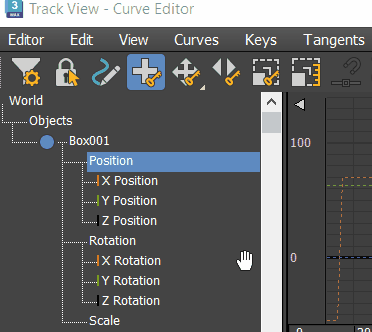

The circled key means the track will be keyed. If you click the circled key, it turns to a crossed key
, which means that track will not be keyed.
Controller submenu
Keyable command.

Position, Rotation, and Scale are on by default. So is IK Parameters.
You can use Key Filters to work on individual tracks selectively. For example, if you are in Track View and the Rotation and Position tracks of a character's arm are keyable, you can use the key filters to turn off the Position filter and only work on the Rotation tracks.

(Set Keys) or press
When the Set Keys button turns red
, it sets a key on the time ruler. The keys are color coded to reflect which tracks are being keyed.
If you don't click Set Keys and you move to another point in time, the pose is lost.
