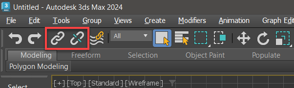

Use the Unlink Selection button to remove the hierarchical relationship between two objects.
Select and Link and Unlink buttons on the toolbar.
Unlink Selection detaches a child object from its parent object.

To unlink a child object from a parent object:
  1. Select the child object you want to unlink.
  2. Click Unlink Selection.
