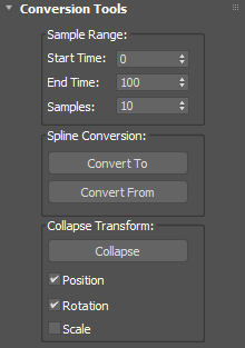

Conversion Tools rollout
Sample Range group
- Start Time/End Time
- Specifies the interval for the conversion. When converting from position keyframes to a spline object, this is the time interval for which the motion path will be sampled. If you're converting from a spline object to position keys, this is the interval over which the new keys will be placed.
- Samples
- Sets the number of samples for the conversion. When converting in either direction, the source is sampled at regular intervals, and keys or control points are created on the target object.
Spline Conversion group
- Convert To/Convert From
- Converts keyframe position tracks to and from spline objects. This enables you to create a spline motion path for an object and then convert that spline to keyframes for that object's position track in order to do various keyframe-specific functions (such as applying constant velocity to the keys and normalizing the time). Or, you can convert an object's position keyframes into a spline object.
Tip: Convert To and Convert From can be used to move an object along a path without using a path constraint.
Collapse Transform group
Generates keys based on the current transformation of the selected object. You can apply this for any type of transform controller assigned to an object, but the main purpose of this function is to "collapse" a parametric transform effect, such as one generated by a Path constraint, into standard, editable keys.
- Collapse
- Collapses the transform of the selected object.
- Position, Rotation, Scale
- Specifies which transforms you want to collapse.
You must choose at least one checkbox to activate the Collapse button.

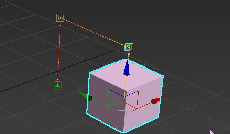

To display an animated object’s motion path:
- Select an object that moves over time.
- Right-click the object and choose Show Motion Paths.
Note: If By Layer is selected in the Display properties for the object, choosing this option automatically sets it to By Object.
The motion path is displayed as a line with squares and dots. The squares are keys while the dots mark the position of the object at individual frames.
Tip: Use the Display rollout to customize how motion paths are shown.

To set an object to use a spline as its animation path:
- Create or open a scene that contains any object and a spline to use as an animation path.
- Select the object and activate Motion Paths mode.
- Click Convert From and then select the spline.
The motion path is created from the spline and the object moves to its start point. If you play or scrub the animation at this point, the object moves along the path.
Note: Any existing animation keys for the object will be incorporated at their current locations into the new path. So, for best results, use a non-animated object.
