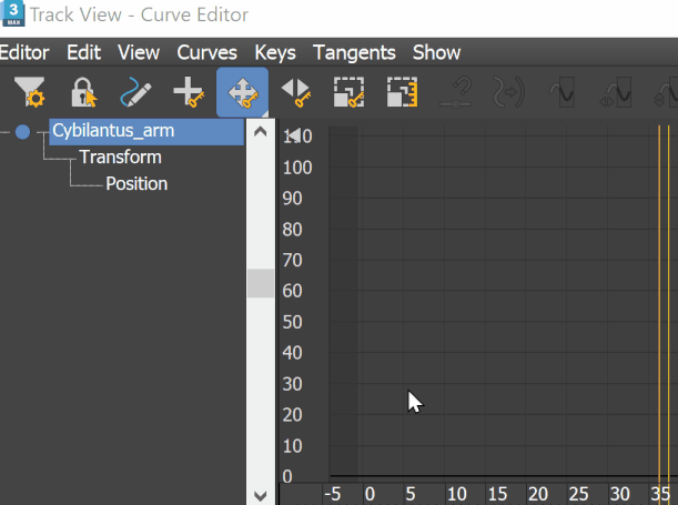

Double-click the label to view the properties of the assigned controller
To view controller properties in Curve Editor:
Do one of the following:
The dialog title identifies the controller type, the item or object name, and the parameter. For example: Noise Controller:-Box01\Position
