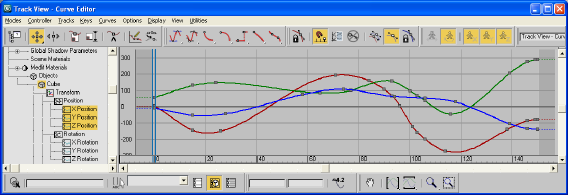

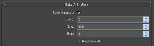

Bake Animation
This option lets you bake (or Plot) animation at export time.
When you activate this option all unsupported constraints and controllers, including the 3ds Max Biped, are resampled into animation curves. You can then import these curves into another application that does not support these 3ds Max constraints.
The plug-in takes the Start and End values automatically from the “timeline” current settings of the host application. You can modify them by changing the values once you activate this option.
Note: Bake Animation Start/End/Step values cannot be saved in presets. The 3ds Max FBX plug-in always derives these values from the scene being exported. For more, see the Preset Bake Animation settings FBX LImitations in the FBX Limitations topic.
The Step value defines how many keys are created per frame, and has a value of 1 by default. Setting a Step of 2 for example, only bakes and exports a key every other frame.
Note: The FBX Exporter will bake animation on any objects that have keys on FBX unsupported channels such as constraints, controllers, and so on.

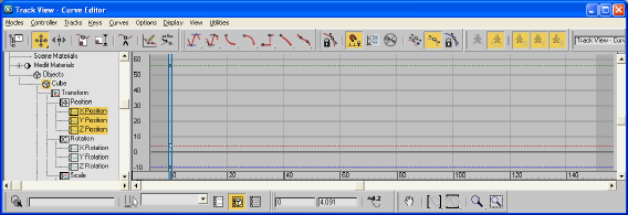

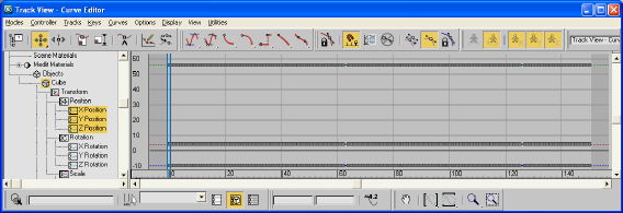

Activate the Constant Key Reducer filter to remove redundant keys. Redundant keys are keys that have the same value, which are equivalent to flat horizontal interpolations on a curve. Redundant keys are often a result of a resampled curve.
Before:
After:

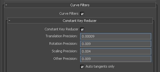

You can set specific thresholds for each type of transform (Transformation, Rotation, Scaling, and Other. Other includes Morph and custom attribute curves, for example).
The default values are:
Values represent generic units. This is why you might need to modify threshold values in relation to the world scale of your scene. This is true for very large or small scale scenes.
If keys are numerically identical, use very small values to ensure that no animation is lost.
If you use this filter to eliminate noise, for example, from motion capture data, then you might need to modify values.
Setting Description
Translation precision Threshold for translation curves in generic units.
Rotation precision Threshold for rotation curves in generic units.
Scaling precision Threshold for scaling curves in generic units.
Other precision Threshold for other curves in generic units.
Auto tangents only This option ensures that only “auto” key types are filtered. Otherwise, keys with interpolation values greater than a certain threshold might be deleted.

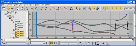

Unroll Rotations
This filter re-evaluates rotation curves to reduce the number of 180' degree rotation jumps for a specified component. You can modify or displace these rotation jumps and/or Gimbal lock with this filter, and not affect the resulting animation visually.
Before:
After:
Note: The Unroll Rotations filter must resample the entire vector of a rotation curve (X, Y & Z components). This resampling lets the plug-in find a new path of values that represent the same rotation.

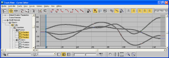

Key Reducer
Activate the Key Reducer to reduce the numbers of keys on animation curves on export. The Key Reducer reduces keys by automatically replacing them with tangents, which maintains the prevision of the animation while reducing the number of keys to speed processing.
You also can use this filter to reduce the number of keys on resampled curves, which lets you edit keys, not dense data.
Before:
After:
Note: There is always a trade-off between the number of keys needed versus the precision of the animation. The more keys you have, the more precise the animation. The fewer keys you have, the easier it is to edit the keys, but there is less precision.

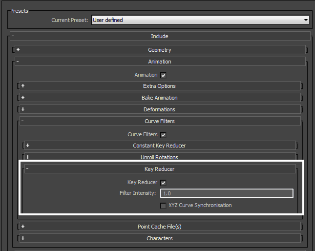

Setting Description
Filter intensity Generic value. In most cases, the default value (1) is enough to streamline the number of keys and continue to remain faithful to the original visual result.
Note: Increasing filter intensity, for example to 4.0, removes more keys, which speeds processing, but results in much less accurate animation.
XYZ Curve Synchronization This option adds keys to the other curves (X,Y, or Z) at every added key so that a key always exists on all three curves (X, Y, and Z) at the same vector for each key over time.
Note: This setting increases the number of keys, but is useful if you want to select a key on all curves at the same time. Game engines often require this for real-time animation playback.
The default values for the Key Reducer filter are a precision value of 1.0 and the XYZ Curve Synchronization option disabled.
